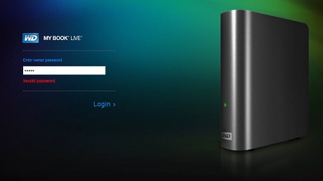

Today, WD My Book owners worldwide suddenly found that all of their files were mysteriously deleted, and they could no longer log into the device via a browser or an app.
When they attempted to log in via the Web dashboard, the device stated that they had an "Invalid password."
"I have a WD My Book live connected to my home LAN and worked fine for years. I have just found that somehow all the data on it is gone today, while the directories seems there but empty. Previously the 2T volume was almost full but now it shows full capacity," a WD My Book owner reported on the Western Digital Community Forums.
"The even strange thing is when I try to log into the control UI for diagnosis I was-only able to get to this landing page with an input box for “owner password”. I have tried the default password “admin” and also what I could set for it with no luck."
Password no longer working in My Book Live source: WD Forum
My Book devices issued a factory reset command
