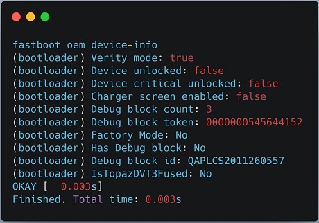

Newer Android versions allow developers to place the device in a locked state to prevent a device from loading modified boot images. As you can see below, the 'fastboot oem device-info' shows that the device is not unlocked.
Fastboot command showing the Peloton in a locked state
While Peloton correctly set the device to a locked state, McAfee researchers discovered that they could still load a modified image as a bug was preventing the system from not verifying if the device was unlocked.
While their test boot image failed as it did not contain the correct display and hardware drivers to operate the Peloton, it showed that modified code could be run on the device.

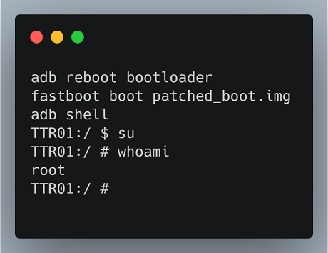

The researchers then acquired a valid Peloton boot image from the device's OTA (over-the-air) updates. They then modified the legitimate boot image to include the 'su' command to elevate privileges on the device.
With physical access to the device, the researchers loaded a modified Peloton boot.img into the Peloton Bike , they were able to achieve root access on the device using the 'su' command, as shown by the image below.
Gaining root access via the modified boot image
While the Peloton Bike  continued to operate and look just like usual, the researchers now had elevated access and could run any Android application they wanted on the device.
