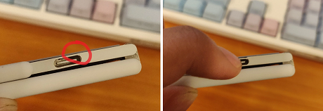

Surface Duo owner Algreimann on Reddit reports that the frame of his Surface Duo has already cracked around the USB-C port.

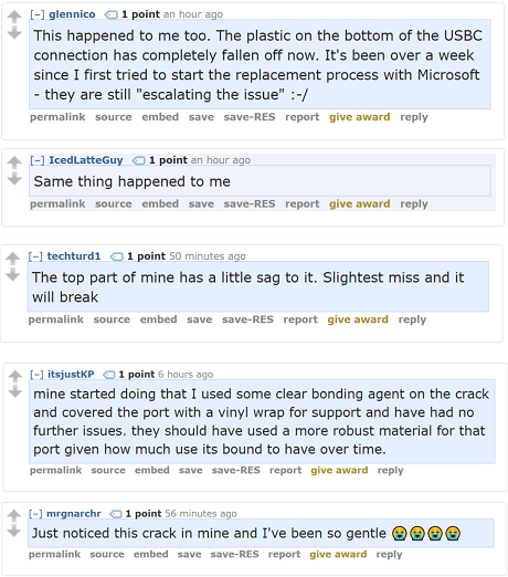

It seems likely that if it happened to one person so close to launch it will happen to many more people over the life of the device. In the same thread, a number of other owners are complaining of the same issue.
More pictures have now also emerged from earlier victims of what now appears to be a clear design error.

Above owner Yi Han warns:
TO ALL SURFACE DUO USERS!!
Please take extra caution on this particular spot of the type c port. Very thin plastic! Extremely easy to break! Mine cracked just by putting the device in the pocket. I’m gonna RMA mine see if they are willing to replace the unit.

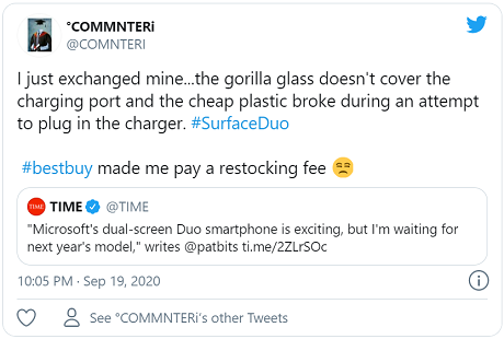

Another owner on Twitter notes that the plastic broke merely from inserting the USB-C cable:
