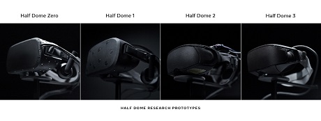

Varifocal
Image courtesy Meta
To address varifocal, the team developed a series of prototypes which it called ‘Half Dome’. In that series the company first explored a varifocal design that used a mechanically moving display to change the distance between the display and the lens, thus changing the focal depth of the image. Later the team moved to a solid-state electronic system which resulted in varifocal optics that were significantly more compact, reliable, and silent. We’ve covered the Half Dome prototypes in greater detail here if you want to know more.

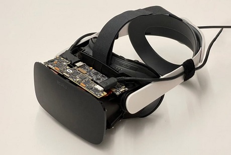

To allow the Display Systems Research team to work more quickly on the issue, the team built a ‘distortion simulator’, which actually emulates a VR headset using a 3DTV, and simulates lenses (and their corresponding distortion-correction algorithms) in software.
Image courtesy Meta
Doing so has allowed the team to iterate on the problem more quickly, wherein the key challenge is to dynamically correct lens distortions as the eye moves, rather than merely correcting for what is seen when the eye is looking in the immediate center of the lens.

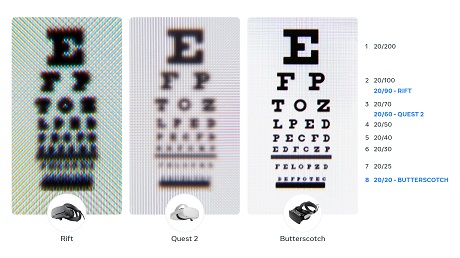

On the retina resolution front, Meta revealed a previously unseen headset prototype called Butterscotch, which the company says achieves a retina resolution of 60 pixels per degree, allowing for 20/20 vision. To do so, they used extremely pixel-dense displays and reduced the field-of-view—in order to concentrate the pixels over a smaller area—to about half the size of Quest 2. The company says it also developed a “hybrid lens” that would “fully resolve” the increased resolution, and it shared through-the-lens comparisons between the original Rift, Quest 2, and the Butterscotch prototype.
Image courtesy Meta
While there are already headsets out there today that offer retina resolution—like Varjo’s VR-3 headset—only a small area in the middle of the view (27° × 27°) hits the 60 PPD mark… anything outside of that area drops to 30 PPD or lower. Ostensibly Meta’s Butterscotch prototype has 60 PPD across its entirety of the field of view, though the company didn’t explain to what extent resolution is reduced toward the edges of the lens.

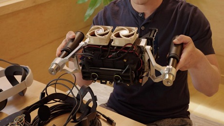

To prove the impact of HDR on the VR experience, the Display Systems Research team built another prototype, appropriately called Starburst. According to Meta, it’s the first VR headset prototype (‘as far as we’re aware) that can reach a whopping 20,000 nits.
Image courtesy Meta
The goal of HDR however is not to fry your eyes, but to give realistic luminance to things that actually are starkly bright in real life. For instance a fire, explosion, firework, or even bright reflections off of a window on a cloudless day. All of these things seem to ‘pop’ in real life because they’re so much brighter than the world around them. Being able to replicate that ‘pop’ of brightness in VR is essential to passing the visual Turing Test, says Meta.
For comparison, Quest 2’s display maxes out at 100 nits, and high-end HDR TVs reach around 2,000 nits. That means the Starburst prototype can produce a range of brightness that’s 10 times brighter than even some of the best HDR TVs out there.

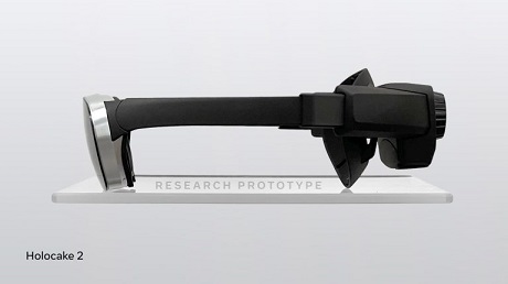

While many of the company’s prototype VR headsets sacrifice weight and size in order to prove those fundamental ideas, Meta is also focused on drastically shrinking the VR headset form factor. To that end, the company has taken its proof-of-concept holographic folded optics research and turned it into a real, working VR headset called Holocake 2.
This impressively compact prototype tackles the two biggest size limitations of contemporary VR headsets: the length of the optical path and the width of lenses.

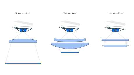

In order for the lenses in a VR headset to do their job, they must be placed a certain distance from the display. If you move them any closer you simply won’t be able to focus the image correctly. But using ‘pancake’ optics (also known as ‘folded’ optics), effectively shrinks the distance between the lens and the display by ‘folding’ the path back on itself using polarization to bounce the light back and forth before finally reaching the eye.
As you shrink that distance you start to see that the thickness of the lenses is actually further limiting how close you can put the display to the eye. To that end, the Holocake 2 prototype uses holographic lenses which are significantly thinner than traditional lenses.
These are essentially thin holographic films that have a hologram of a traditional lens embedded within them. Even though they’re thin, they manipulate light similarly to the thicker lens which they are modeled from.
Image courtesy Meta
The combination of holographic lenses and pancake optics—hence holo cake—is the key that makes Holocake 2 so compact.
“The creation of the holographic lens was a novel approach to reducing form factor that represented a notable step forward for VR display systems,” says Meta. “This is our first attempt at a fully functional headset that leverages holographic optics, and we believe that further miniaturization of the headset is possible.”
Image courtesy Meta
However, this is a PC-tethered headset which means that it will need some additional bulk (compute and battery) in order to reach the standalone form factor that Meta is gunning for. And unfortunately, Meta says, Holocake 2 requires a laser light source to make its holographic optics work well, and they aren’t yet at the size or cost needed to be practically implemented in a real product.
