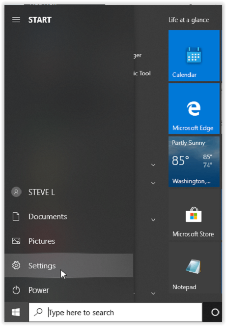

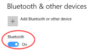

1. Click the Windows “Start Menu” icon, and then select “Settings.”
2. In the Settings menu, select “Devices,” and then click on “Bluetooth & other devices.”
3. Switch the “Bluetooth” option to “On.” Your Windows 10 Bluetooth feature should now be active.

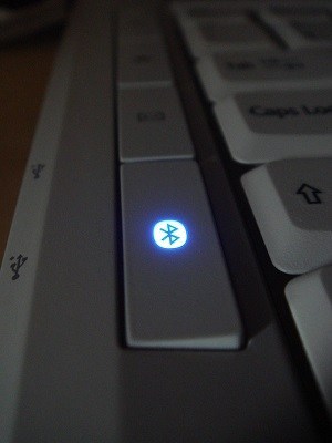

Option #2: Turning Bluetooth On using Keyboard
1. Look for the “Bluetooth” icon on your keyboard and click it to turn Bluetooth On.
2. If the icon appears in the Function Keys at the top, you may have to press and hold the “Fn” button first, followed by the “Bluetooth” key. This scenario depends on your PC’s current keyboard configuration.

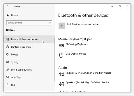

Connecting your computer to a Bluetooth device is as simple as finding it on the list in the “Bluetooth & other devices” menu. Of course, the device needs set to pairing mode and must be discoverable. You can find the details on how to pair any Bluetooth device in its instruction manual—well, almost.
To connect to a device, click on it from the list of discovered Bluetooth products, and then select “Connect.” The link should get established quickly.

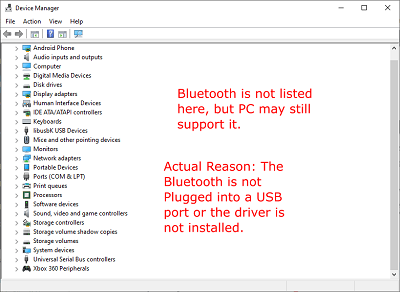

If nothing has worked so far, try using “Device Manager” to see if Bluetooth is listed. Take note that your PC may support Bluetooth functionality and still not show up in the devices list. That scenario occurs when there is no Bluetooth driver set up for the external adaptor or internal component. However, internal Bluetooth devices generally get detected, whether installed or not.

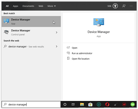

1. Click on the Cortana search bar and type “Device Manager,” and select it from the list.
2. Look for Bluetooth entries in “Device Manager.” If you see them, then the PC supports Bluetooth, but it may not be working correctly. Bluetooth locations in “Device Manager” include Bluetooth, Network adapters, and Other devices. If the item and driver are not listed, move on to step 3.
3. As previously mentioned, your PC can still support Bluetooth and not show it in Device Manager. In that case, you need to install the appropriate driver.
If you find a Bluetooth device within Device Manager and you still can’t turn it on, the issue lies elsewhere.

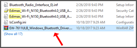

Drivers are updated either manually or automatically. The manual method might be a bit tedious, but it will do the job. Just find out which Bluetooth device your computer is using (from the Device Manager). Then, search the name of the device and download the drivers from the official website.

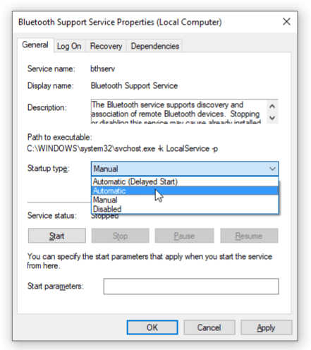

Bluetooth Support Service

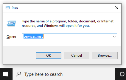

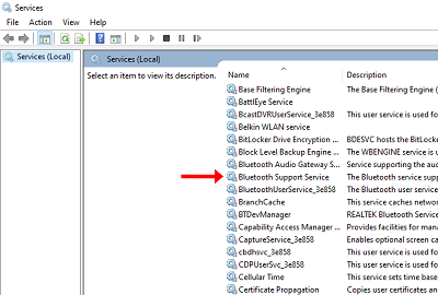

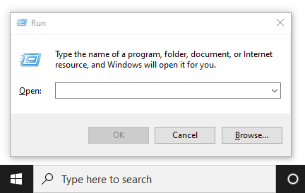

Now, we’re going to have to delve a bit deeper. If none of the above solutions worked, it’s time to use the “Run” feature.
1. Hold down the “Windows” key and press “R” to bring up the “Run” window.
2. Type “services.msc” without quotes in the command box, and then press “Enter” or click “OK.”
3. A new window will appear with a list of entries. Right-click on “Bluetooth Support Service” and select “Start.” If you can’t click the Start option, choose “Restart.”
4. Unless you want to repeat the process above every time you start your computer, there’s one more step to take. In the “Services” window, click “Bluetooth Support Service” again. Navigate to “Startup type“ found in the “General” tab and select “Automatic.” Click “Apply” and then “OK” if needed.

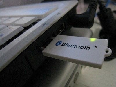

Although one or more of the above methods generally solve Bluetooth problems in Windows 10, there’s a small chance that you’re still struggling to get Bluetooth to work. In this case, contacting the manufacturer or your retailer would be your best bet. If not, getting a USB Bluetooth adapter should help.
