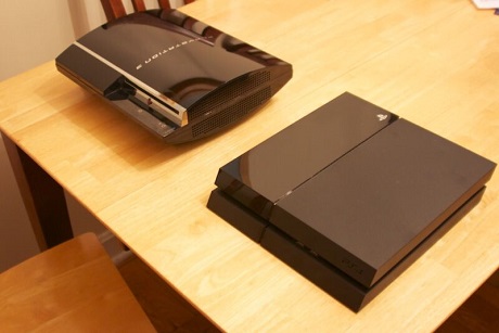

Unless something changes, an issue lurking in older PlayStations' internal timing systems threatens to eventually make every PS4 game and all downloaded PS3 games unplayable on current hardware. Right now, it's not a matter of if but when this problem will occur.
